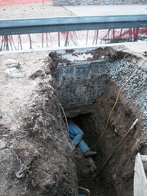

Two years ogo had a brand new pool, broken floor returns, listening with the xlt narrowed it down to two returns??, then removed all the floor return plugs and inserted the hydrophone down each one, absolute confirmation, the roar of the leak pegged the led readout at 99 and I had to remove the headphones, the sound was so load that the pool builder could hear the headphone sound while standing on the opposite side of the pool, was able to pinpiont the leak within 2 inches, next day the builder excavated a tunnel under the pool to get to the leak, see attached tunnel photo, my location was spot on.
tunnel1.jpg - 76.27kb

brrscuba, Im glad that you got this pool repaired but would be very careful about digging a hole like that. I think that OSHA would have something to say about not shoring the side walls to prevent cave-ins.
[*] posted on 18-3-10 at 06:10 PM Reply With Quote
I agree with you. I had no part of the tunnel. Builder did it the day following the dive.
