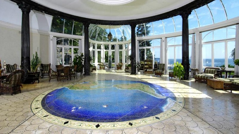

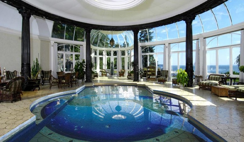

This is the most beautiful and amazing pool I have repaired leaks in.
With the floor UP, the building is transformed into a dance parlor, with the floor lowered it is an amazing pool with a panoramic view into Long Island sound. The estate is currently for sale for $42m
GreenwichPoolWith FloorDown.jpg - 161.8kb
[*] posted on 29-10-10 at 06:13 PM Reply With Quote
Here is the photo with the floor raised
GreenwichPool.jpg - 164.96kb

What type of pool is this , Liner ? Nice picture.
[*] posted on 30-10-10 at 05:01 PM Reply With Quote
It is a gunite pool, under the floor are huge hydralic lifts, 2 for the main floor and two smaller ones for the semi-circular areas on each side, the entire floor (of the room and the pool/dance floor) is hand inlaid tile

Are you freaking kidding me? I mean I thought I've seen some spectucalar stuff down here in Windermere,FL (where Tiger Woods, Dwight Howard,Shaq,et al.) have houses. This pool is awesome!
So let me get this straight there is hydraulic lifts inside the pool through the gunite or mounted on the pool shell/floor?
Where did you end up finding the leaks? Will the hydraulics pose a problem later on for leaking in that area?
Good stuff man thanks for the pics.
[*] posted on 17-11-10 at 08:37 AM Reply With Quote
Yes, there are four hydralic lifts mounted on the floor of the shell.
The leaks were stress cracks surrounding one of the two main lifts, yes I look forward to future leaks reoccurring. They raised the dance floor up three feet above the room floor to allow me to inspect the shell floor. They also have another jawdropping feature on the property, They have a 1/12 scale Brooklyn Bridge as a boat dock, the bridge goes out to a rock outcropping in LI Sound, it allows guests with large yachts to visit, and was built by Roebling Company that designed of the Brooklyn Bridge.

Are the lifts using pool water or other means?
[*] posted on 15-2-11 at 07:45 PM Reply With Quote
Visualize large cylindrical lifts, like you see an an auto repair garage,
