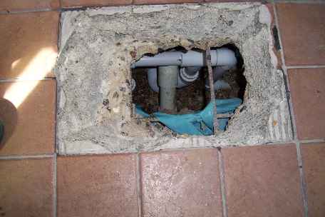

We have the leak pin pointed to behind a return fitting. Tried a light string and float from the furthest point first, the string flew in the return, masses of it! tried from the center return and only a foot of string went in. When I was leaning over the edge and put the plug back in, it dawned on me, I could no longer hear running water. Site is a little different, as its deck level and takes a long time for all the drips into the trough to stop. Used the underwater mic so we could hear what was going on, for future reference, ears are still rushing! Will let you know what we dig out.

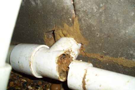

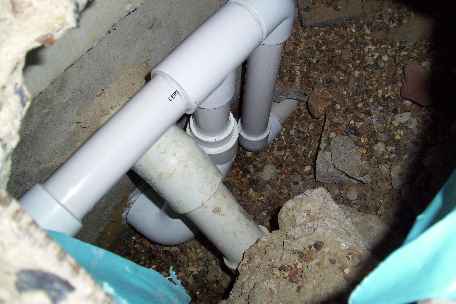

Thanks for the pics advice,
Poolman has attached this image:
leaks 018.JPG - 16.02kb

so you can't attach all at once!
leaks 014.JPG - 16.56kb

ok so they are not in order!
leaks 012.JPG - 13.19kb
