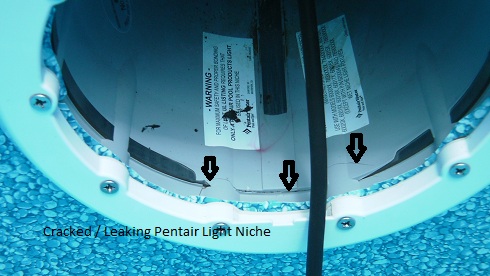

[*] posted on 20-11-11 at 09:40 PM Reply With Quote
Photo of the leaking, cracked, defective Pentair light niche
043.JPG - 69.17kb

[*] posted on 23-11-11 at 10:05 AM Reply With Quote
good picture bruce. i have also seen cracks throughout the niche including in the twelve o clock position.
