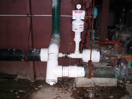

The worst SVRS installation I've ever seen:
8 inch main drain reduced to 2 inches for the svrs
Found at a commercial pool in NY

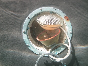

This was reinstalled as you see it after a company installed the new liner

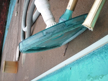

The customer bought a new pole to replace the one he broke trying to dislodge the vacuum, it was vacuumed tight against the bottom, he didn't notice the worn brushes (he had made 20 holes where it had gotten stuck)

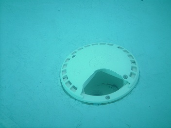

The customer modified the drain cover and taught his children how to dive down and plug or unplug the main so he could vacuum with full suction
He was upset at me for removing it and installing a new VGB cover while I was there for leak repairs

That light is great ! Simlar to the bodges we get to see. If its worth fixing its worth fixing well, but herberts hang around, you keep us in buisness!
