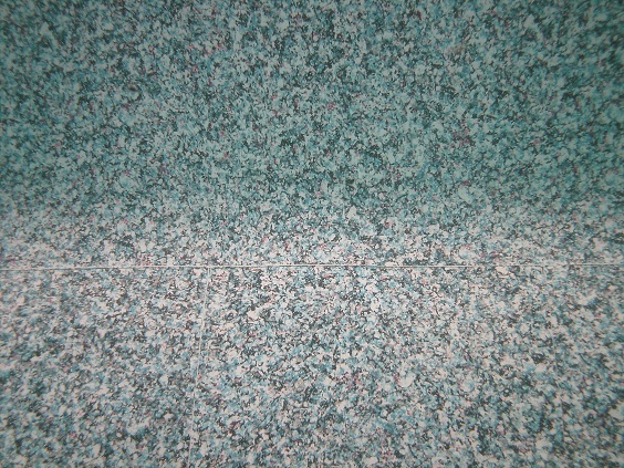

Thank You To The Leak Trac
A big thank you goes to the Leak Trac,
I call this pattern "The Nightmare Pattern"
There are 3 holes in this image
The successful repair would have been impossible without a Leak Trac
012.JPG - 185.64kb

Lets play 'Spot The Hole' anyway we can mark the pic with a white cross ? :)

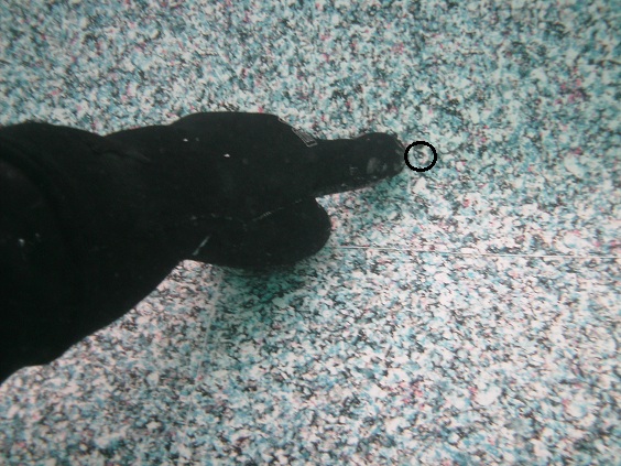

The larger hole was slightly to the right of the center of the earlier picture
circled in this photo
015-X.jpg - 138.03kb

looks like the base of the wall. were all 3 at a similar height? were there more in the pool? my guess is dolphin auto cleaner, vacuum head or grubs. the more black/very dark dye in the liner the tougher they are, but they are still visible in the pool. the pic is pretty difficult to see the holes
[*] posted on 21-12-11 at 08:25 PM Reply With Quote
it had 7 holes, all but one on the wall, just above the cove / slope to the deep hopper, yes I believe there is something in the roller of an automatic cleaner, even with the Leak Trac id it was difficult to find the smallest hole
