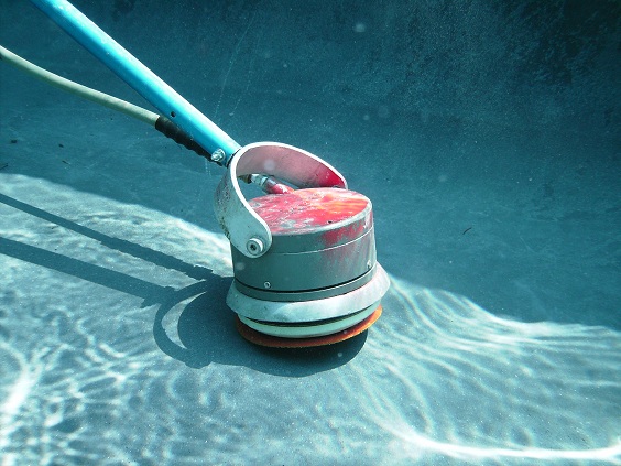

Last season I got to operate this Hydrazzo polishing tool to remove stains caused by the fill water running down the length of the pool as they slowly filled the new pool with a garden hose, it was kind of like riding on a floor polisher underwater:P
055.JPG - 111.78kb

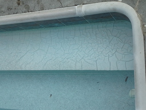

Customer sent me this picture of the top step of his 2 year old pool
He wanted to hear that the liner was defective, he confirmed my suspicion that he uses "floaters", chemical tab floaters in his pool. and that they often got stuck on the top step. The chemical feeder sitting on the step ruined the vinyl, no defect, the pool liner installer never mentioned not using floaters on lay-over liner stair pools.
Bruce R. Roache
PoolRepairDiver.com
20120917_173824.jpg - 80.66kb

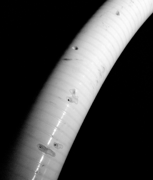

pinhole leaks eaten through Flex-Pipe by termites:o
PinholesInTermiteFlexPipe.jpg - 73.21kb

Flex hose
Believe it or not, I have found new flex hose still in wrap with the same the exact same holes. I sent a piece back and they said it is a factory defect.
Dave

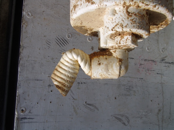

FlexPipe, ruined by chemical tab use in the skimmer
PoolRepairDiver.com
flexskpipe.JPG - 130.82kb
